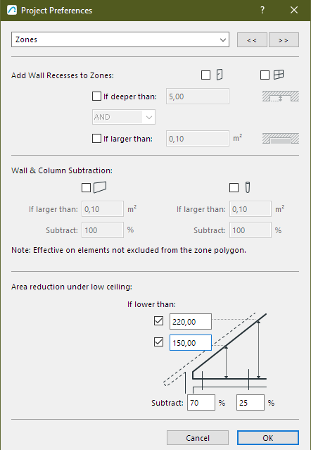

Under Project preferences, there are settings for zone calculation. These should be expanded, or, as in my proposition below, completely re-imagined.
These are current settings. Some countries have legislation that require different and more nuanced settings.
