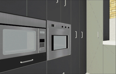

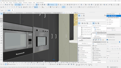

Entry Description:
In this submission, I showcase the operability of the oven door created for the Universal
Accessible Kitchen proposal, developed during my exchange program in Architecture at
Hasselt University. The project mandate was to introduce iterations to an existing
building that previously did not adhere to universal design standards.

Hey @Vhuhwavho Moraba I like your creative & non-standard use of the new Design Option tool. This shows very well Archicad's long standing versatility through all version releases.
This also gives me some ideas for a workaround for one of my Feature Requests that is still pending. That is to have the ability to have global control Object settings via Model View Options like the opening angle / width of Doors, Windows and Objects like these ovens, fridges etc. This workaround via the new Design Option tool will make it possible to have doors, windows & objects CLOSED for drawings and OPEN for render views until we get the Model View Option control as a feature.
Great thinking on your entry 👌
