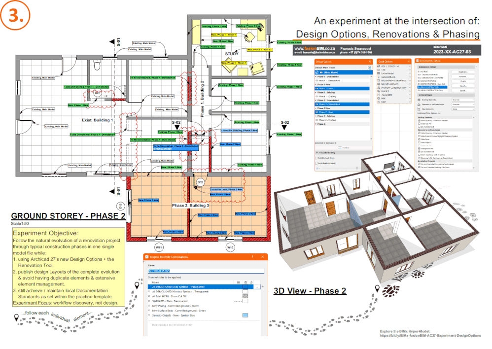

This is an AC27-3001 Experimental project - Combining the new Design Options, Renovation Tool & Phasing in the fusionBIM Archicad workflow & template.
Experiment Objective: Follow the natural evolution of a renovation project through typical construction phases in one single model file while:
  1. using Archicad 27's new Design Options + the Renovation Tool,
  2. publish design Layouts of the complete evolution & avoid having duplicate elements & extensive element management.
  3. still achieve / maintain local Documentation Standards as set within the practice template.
  4. discover limitations, challenges & best practice to adapt the practice template to make maximum use of the new Design Options Tool.
Experiment Focus: workflow discovery, not design.

Your workflow is interesting ! but i get confused on demolition by stages, can you explain more your workflow for phasing please ?
Thanks
Hi @Ahmed_K
The basic flow of this Renovation project exercise is, we start with existing building elements.
Some of these elements will be demolished + new elements added in "Phase 1".
Then at the start of "Phase 2", all original Existing + "Phase 1" new elements become / are set to Existing.
Now all changes are made for "Phase 2" (demolish elements + new add elements).
A few keys to achieve the Layout drawings for these Phases in the same model is:
  • Drawings on the layouts are set to Manual update
    ie. you update EVERYTHING for the drawings for the Existing phase layout,
    then complete the model & views for Phase 1 layouts and update the Phase 1 layouts, etc, etc
    NB: After changing the model in ie. Phase 2, only update drawings on layouts of the latest Phase 2 & leave previous layouts as they are.
  • To avoid "duplicate elements" for different Design Options,
    you MOVE an element from Existing phase to now show in Phase 1 and change it's status from Existing to Demolished, etc, etc
This way we combine Design Options & Renovation & Phasing (in the same model & no need for extra layers / any extra attributes / properties).
