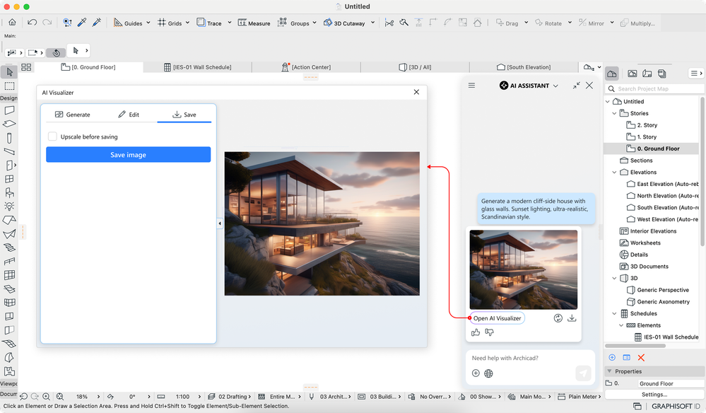

Turning an idea into a visual concept is now much smoother thanks to the new connection between AI Assistant and AI Visualizer. You can start with a short prompt, generate an image directly in AI Assistant, and then refine it in AI Visualizer – all without breaking your flow or leaving your design environment. Please note that image generation from AI Assistant is always based on your text prompt, and if you want to create appealing visuals from a 3D view or an uploaded image, you can still use AI Visualizer directly.
With this integration, you can quickly explore multiple design directions for the same brief, test different moods or materials, and polish the best results for client‑facing presentations. It’s especially useful in early design stages, when you want to communicate intent fast or iterate on visual options without setting up complex rendering scenes. Instead of jumping between tools, you stay in one continuous workflow from first idea to saved image.
Here’s how it works in practice. You type your prompt in AI Assistant and include a trigger word like “visualize” or “generate” to let the system know you want an image. The AI Assistant processes your request and creates an image based on your description. If you want to tweak the result, you simply click “Open AI Visualizer” to move into AI Visualizer, where you can edit, adjust, and finalize the image using the available tools, then save the final version to your computer.
To get consistent results, start your prompts with verbs that signal image creation, such as “create,” “generate,” “illustrate,” “render,” “sketch,” or “visualize.” For example: “Generate a modern cliff‑side house with glass walls. Sunset lighting, ultra‑realistic, Scandinavian style.” Small prompt changes can produce noticeably different outcomes, so it’s worth experimenting a bit to see what best matches your design intent.
