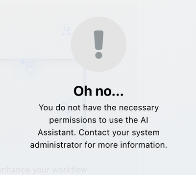

Although I have an official license, the AI Assistant does not work for me. The following message appears:
"Oh no...
You do not have the necessary permissions to use the AI Assistant. Contact your system administrator for more information."
What do I need to enable in the system settings (Win 11) for it to work?

we experienced the same issue - you need a cloud licence or software license instead of a perpetual license (dongle).

currently, the only way to fix it is by throwing some more good ol money into graphisofts account.
Thank you for sharing this case, and for raising such an important question.
AI Assistant is part of Graphisoft’s new generation of cloud-enabled solutions, which means it requires a cloud license to function. I'm sorry, it’s not available with perpetual or key-based (dongle) licenses. This isn’t about excluding users, it’s simply that AI services rely on a secure cloud infrastructure.

All that you say makes sense... but AC 29 has exactly the same issue that AC 28 had with regards to cloud-based functionality:   an inappropriate error message is displayed when clicking on the AI button.  See attached.  It is not an issue of "permissions"... the error message should clearly state that the functionality is only available with cloud licenses, and perhaps provide a link to more info.   It took one or two hotfixes AC 28 before the proper error messages for cloud functionality were displayed there...
