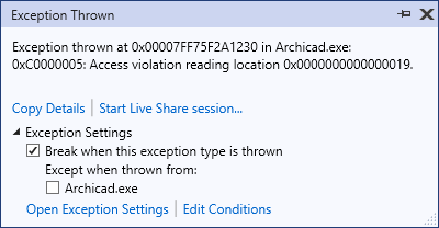

This is the exception detected by Visual Studio
I also tried running the AC25 addon and it works fine so this looks like a problem for AC26 API
