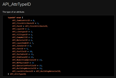

I am not finding compSlabID in attribute.
LeeJaeYoung
1. I can't find compSlabID in attribute.
I don't know why you thought slab had a profile ^^
element.wall.profileAttr
element.beamSegment.assemblySegmentData.profileAttr
element.columnSegment.assemblySegmentData.profileAttr

I found that the composite slab ID is the same as the composite wall ID.
compSlabID = compWallID
