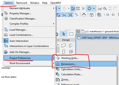

why not change the settings in the Project Preferences?
Working Units is what will be displayed in your dimension tracker, door / window sizes, wall heights etc. if you set it to Meter, your door leaf will be 0.9 x 2.04m in size. if you set it to Millimeter, it'll be 900 x 2040mm in size.
the Dimensions settings will be the output of your dimensions & will print / publish depending on what you've set it to. there are already some out of the box Dimension Combo in there. see what fits best, otherwise make it suit your own.

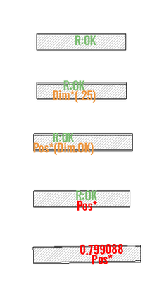

We have a few ways of trying to avoid it.
The grid is one, but it is too rigid in such a way you'll always turn it off eventually.
We even crafted a custom label in GDL meant for auditing, to figure out if elements X and Y coordinates to the project origin are divisible by 0.25, and if their rotations are OK.
But once inaccuracy is there (Projects go through many different hands), having to deal with it can be frustrating.
Since I'd be able to instruct exactly what I'd want that imaginary add-on to do, it seems to me a feasible thing. I might dive into crafting add-ons at some point just to put up that thing 😅
Archicad 27 / Windows 11 64

2022-10-24 06:32 AM
yes, we've started to implement model checking tags such as that in our template, thought not as clean as yours. it's a shame it's gotten to that degree & still annoyed it's not dealt with at the earliest stage -- during the modelling of elements.

2022-10-24 04:33 PM
I run two different dimension systems that can be switched in the Quick Settings at the base of the screen. The standard one is WYSIWYG as published and assigned to the View settings. The other shows the smallest value possible, so any dimensions can quickly show the errors without the displayed extra accuracy impacting the View & Published layout.
