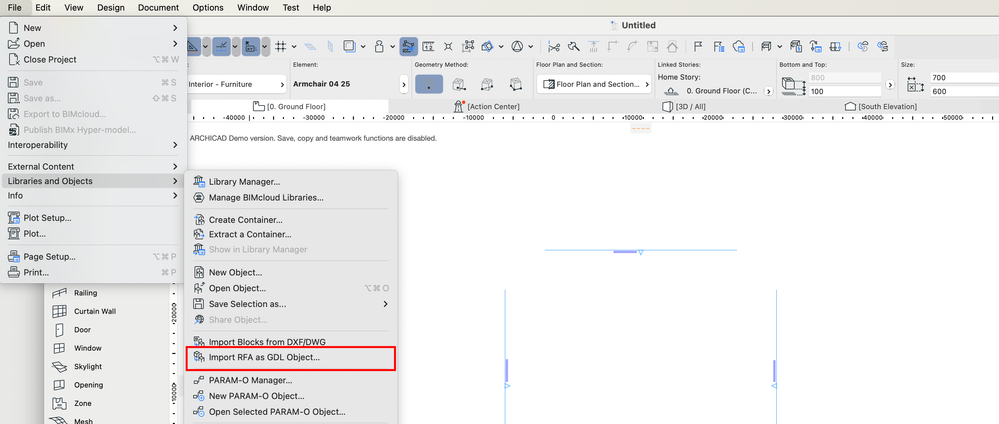

kency
Looking for something similar.
Is there any option  in Add-On API to invoke the RFA As GDL menu as shown in the screenshot?  @Akos or @BerndSchwarzenbacher or @Viktor Kovacs
Thank you!
Hi Kency,
I think it's not possible unfortunately.
Best,
Bernd
