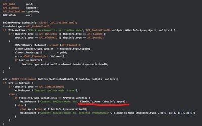

I found a suitable example in SDK.
It works properly for: window (return DWRC), door (return ROOD) , lamp (return HGIL)
For wall or column WriteReport return empty space (simply nothing)
Here is the link to the Example code from SDK:  APIEnv_​SetToolBoxModeID
and code - I sign the line which return "nothing"
Do you have any advice pls?
