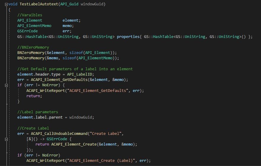

I'm trying to change a label's text to an autotext, which depends on it's parent type in this case. I got the key and value of the autotext that I need. Now I'm trying to insert the autotext into the label text, but haven't succeeded yet.
I'll really appreciated any solution.

- First of all, I created a default label element and change it's parent to a given window GUID (See attached TestLabelAutotext picture), Then:

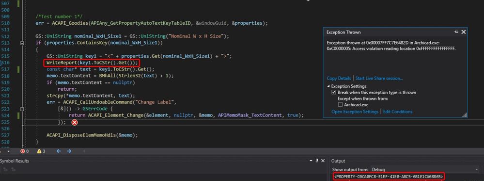

1. First, I tried to use the relevant key given by the Hash table that I get when using the APIAny_GetPropertyAutoTextKeyTableID function.
It gives the format of PROPERTY_ (GUID) without the <> enclosure so I added it manually. When doing that, I get the exception (see picture Test1).

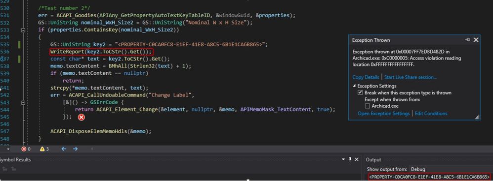

2. I tried to add the format of PROPERTY_ (GUID) manually, and I got the same exaption (See picture Test2)

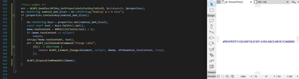

3. I tried to change the format of PROPERTY_ (GUID) without using the <> enclosure. The label's text was changed, not to the autotext I need but to the format of PROPERTY_ (GUID) itself (See picture Test3)
