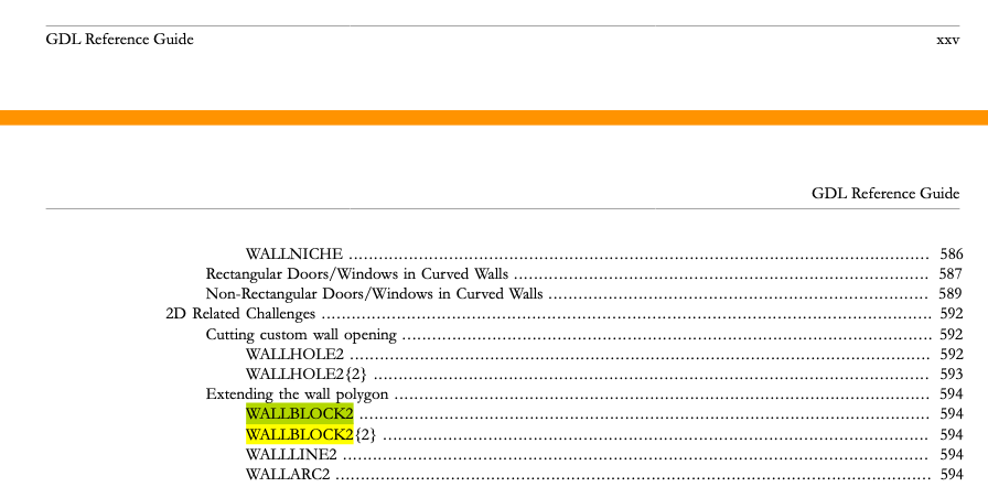

@Jochen Suehlo I have seen POLY2_B in GDL, where do you get "WALLBLOCK2" from, it isn't a standard listed function?
Jochen Suehlo
@DGSketcheryes, shurely:

@Jochen Suehlo I'm due an eye test... ðŸ˜¬
New to me, never used it, but from the manual it is only considered as part of an opening object, much like the Wallhole command, so it may not function in a different object type?
This command can be used in the 2D script of door/window objects only.
You have probably done this but in addition to setting the FrameFill to 7, have you have set the edge status flags to 1?
