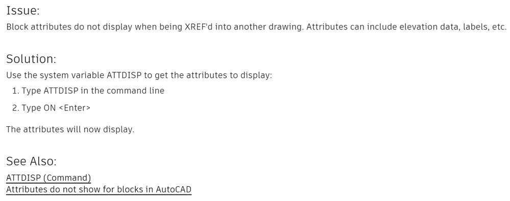

Is it possible that you are trying to xref the .dwg generated with Archicad into AutoCAD ?
That would not display the Block Attributes even if they were in the Archicad generated .dwg
