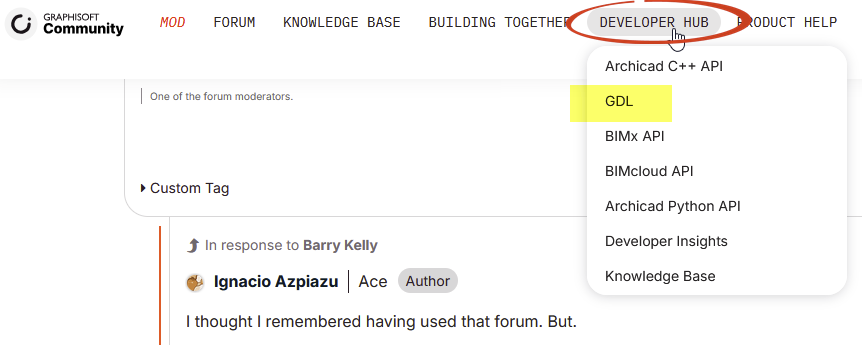

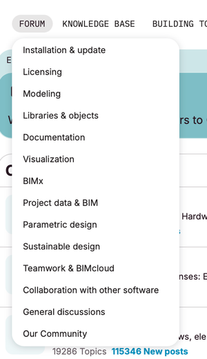

@Ignacio Azpiazu wrote:
[btw2: we have a Param-O post label but not a GDL post label?]
That's is because the post was in the wrong forum.
There is a GDL forum where it is obviously a GDL post, then just label as question or discussion.

I thought I remembered having used that forum. But.
2026-07-08 07:12 AM
It hides in the developer's section.
Not really a problem.
Someone will just move it if they think it needs to be moved.

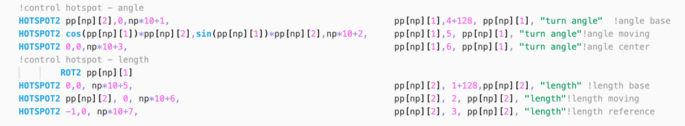

2026-07-08 07:39 AM
I am pretty sure you can't combine length and angle moving hotspots together.
I usually have the length hotspot that rotates with the angle as you have done, but then define the angle hotspot with half of the length or length x 0.95 or some other factor.
2026-07-08 03:42 PM - edited 2026-07-11 06:01 PM
Yes, making them separate works, the point is having them overlap so that you modify length and angle in a single move (just as with x-position and y-position length hotspots).

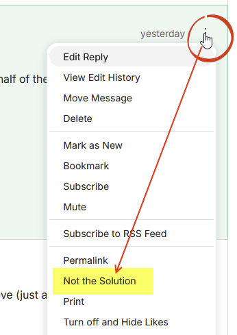

Re: forum and hiding a GDL forum in a “Developer Hub”, just one more of the Verschlimmbesserungen that have so successfully messed up everything over a few years now. Just as the unavailable Undo for my accepting your post as a solution with a wrong click. But don't get me going because then I start getting messages saying I need to be more polite and pretend everything works fine.
2026-07-09 02:28 AM
You should be able to un-mark an answer as the solution, but you have to go into the post options.
If you don't see this, let me know and I will un-mark it.
