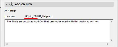

I am having trouble  with my users loading my add-ons.  In short, an add-on will load for me, but not anyone else.
The details:
I keep an area for development code [G:\dev\v22, and similar] separate from an area for production code [G:\bin_22. and similar]:
I set my pointer in the Add-On Manager to the dev area:
and the pointer of the production staff to the production area:
When my development effort reaches a bug free milestone, I copy the .apx file, and only the .apx file, from deep in the dev area to the production area associated with the appropriate ArchiCAD version, making it available to all of the users on the production staff.  This strategy has worked well for me since AC22.
However, in AC27, when I copy a successful build for an add-on that works for me and my dev environment
to the production environment, the same exact .apx file will not load for any of the users in my test group.
I have verified that network connection is active.
I have verified that we all are running the same build.
I have verified the setting of the Add-On Manager pointer.
Another oddity is that when I switch to the production environment, these add-ons load fine.  When I switch a user to my dev environment, the add-on will not load.
Any ideas?

My best guess is that something is not available on the users' computer that is needed for the Add-On to load. It may be a C++ redistributable or something like this. I would check the apx with dependency walker on the users' computer: https://www.dependencywalker.com/.

Solution for my situation:
In CMakeLists.txt file, I made this edit:
# set (CMAKE_CONFIGURATION_TYPES Debug;Release;RelWithDebInfo)
set (CMAKE_CONFIGURATION_TYPES Debug)
Using the dependency walker, I discovered my dev machine was using the .dll files marked here:
I also discovered the production machines were missing these .dll files.
A bit of research into these files uncovered
Reconfiguring CMake from 'Debug' to 'Release' mode solved the problem since the versions of these .dll files [without the 'D' suffix in the file name] were used by the Add-On and available on end user machines.
And one more key step [apparently] is to press the link in the .json file editor to 'Save and generate CMake cache to load variables'.  It is not enough [apparently] to Project > CMake Cache > Delete Cache and then Generate.
