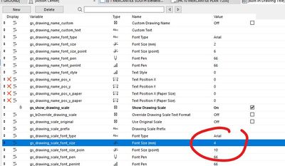

I'm trying to edit the text size of the "Scale" of the Built-in drawing title.
I really don't understand the script settings, but it seems the text size is locked.

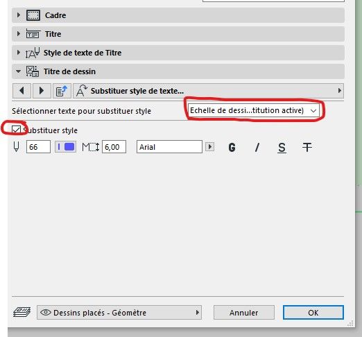

No need to edit the code for this you can do this with to drawing parameters:
