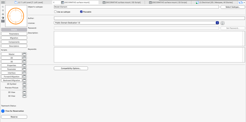

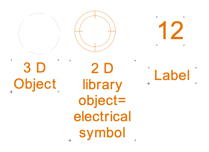

Thank you for your time and attention. I am working on electrical layouts and the roofs for this residence are steep. I would like to have a better way to see it so I may edit. Please, I want to edit the electrical symbols, which are library objects, to do two things:
1. Include a 3D morph that I can see in the 3D window
2. Show the object's ID. I am going around it by adding a label later, yet it's another element to edit.
Again your time is very valuable and I appreciate your feedback. Best regards.
Screen Shot 2022-07-04 at 23.50.32.pngScreen Shot 2022-07-04 at 23.51.19.png

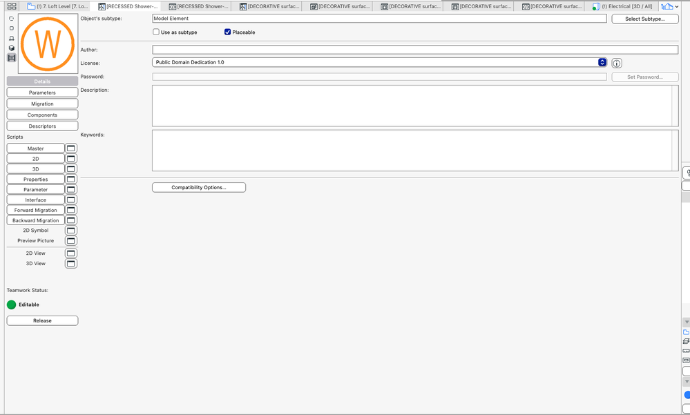

I am starting with a 2D rather than a 3D object. I have changed the 2D Symbol for a 3D library part before, and this is new. This other object does have script for text, and I wonder if it could match the object's element ID instead. Would you know the script for this, please?
Screen Shot 2022-07-05 at 00.10.27.pngScreen Shot 2022-07-05 at 00.10.33.png

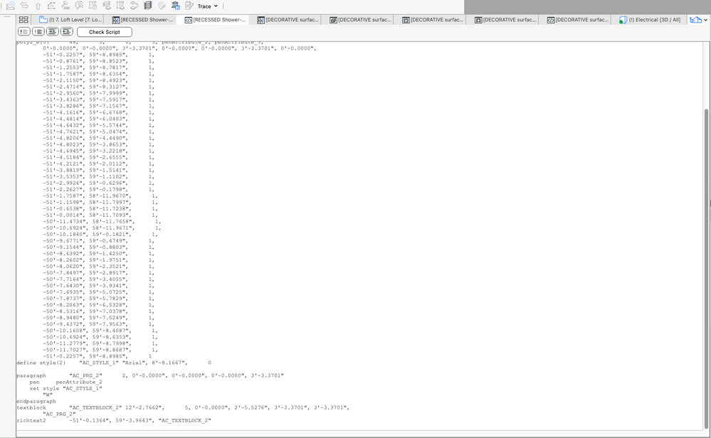

David,
Thank you for your line of code.
Please, allow me to ask for further help. I am trying to write the code to change the text size and location. Code below
! Name : RECESSED Exterior Downlight.gsm
! Date : Tuesday, October 16, 2018
! Version : 22.00
! Written by Archicad
mul2 A/0.289280, B/0.289160
add2 65'-11.0782", -51'-5.5596"
set line_type lineTypeAttribute_1
pen penAttribute_1
fill fillAttribute_1
poly2_b{5} 5, 3, 0, 3, penAttribute_2, penAttribute_3,
0'-0.0000", 0'-0.0000", 3'-3.3701", 0'-0.0000", 0'-0.0000", 3'-3.3701", 0'-0.0000",
-65'-11.0782", 52'-4.9439", 1,
-65'-11.0782", 51'-5.5596", 1,
-64'-11.6892", 51'-5.5596", 1,
-64'-11.6892", 52'-4.9439", 1,
pen penAttribute_2
line_property 0
Text2 0, 0, GLOB_ID
circle2 -65'-5.3713", 51'-11.2486", 0'-4.5973"
2RA Building Workshop
www.2rabldgworkshop.com
11th Gen Intel(R) Core(TM) i7-11800H @ 2.30GHz. 16.0 GB. NVIDIA GeForce RTX 3060 Laptop GPU.
ArchiCAD 25. 5002 USA Full
I figured out how to change the text location, but I am also trying to figure out how to change its size
