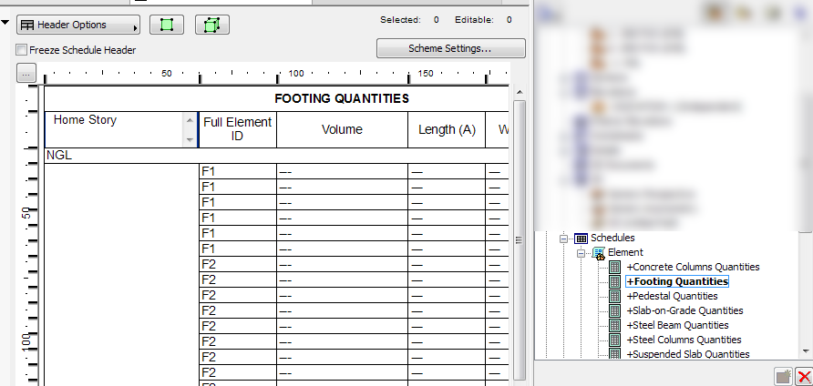

Is there a way on getting the list of elements from 'Schedules'. The screenshot shows list of 'Full Element ID' (and other values). I want to get a list of these elements. Also, get the list of all available schemes from 'Scheme Settings'. Something like:
GetSchemeList(schemeList)
for (i = 0; i < schemeList.size(); i++)
    GetSchemeElements(schemeList, elemList);
    for (j = 0; j < elemList.size(); j++)
        API_Element elem;
        BNZeroMemory(&elem, ...);
        elem.header.guid = elemList;
        ACAPI_Element_Get(&elem, ...)
        // process elements here

I've already found a way to get the list of schedules/schemes through Navigator API.
