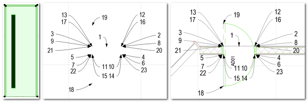

I've created a function that prints the API_PrimHotspot of the parent element of an API_SectElemType (based on its parentGuid) from an elevation view. When I mapped the coordinates of the neig of these primitive hotspots, it fits perfectly on the floor plan view of the object (door in this case).
The question is: How do I get the hotspots of an elevation view?
BTW, the returned API_PrimHotspot has the following values:
head.typeID: API_ZombiePrimID
head.layer: 0
head.pen: 0
head.drwIndex: 0
head.renovationStatus: API_DefaultStatus
loc: <<varies>>
neig.neigID: APINeig_Door
neig.guid: <<door GUID>>
neig.inIndex: <<shown in the attached image, 1-23>>
neig.flags: API_NeigFlg_Normal
neig.elemPartType: APINeigElemPart_None
neig.elemPartIndex: 0

EDIT (2015 Sep 03):
Using the hotspot's memo values for dimElems, I was able to get the inIndex of the door's hotspot on elevation view: 1-4 for the four corners; and, 25-26 for the two inner corner on top. These indices are different from the original post. As you can see, index 1 on previous post is in the middle while here it is in the side. Also, indices 25 and 26 is not on the original post.
