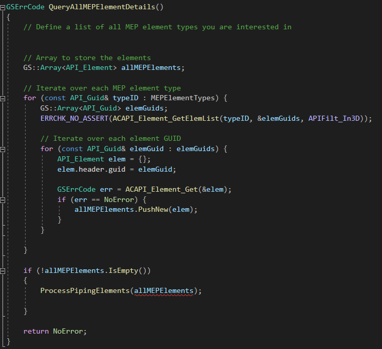

Hi Ralph,
Thank you for your previous response. I'm currently working on extracting polyline data for all MEP elements in my model. Here's the workflow I'm implementing:
  1. Retrieve All Elements:
    • I use ACAPI_Element_GetElemList to get a comprehensive list of all elements in the database.
  2. Filter for MEP Elements:
    • From this list, I filter out the elements that are of the MEP type.
  3. Extract Polyline Data from Routing Elements:
    • For each MEP element identified as a RoutingElement, I extract the polyline data.
Although I've implemented this workflow, I'm not getting any results. Can you please help me identify what might be going wrong or suggest any improvements?
Thank you!

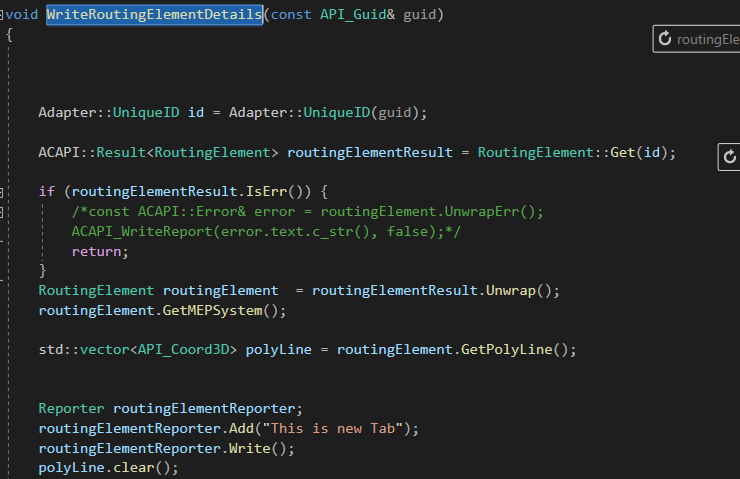

Amit Tiwari
In the third step, I am not able to obtain any polyline data; First two steps succeed. When I use the following line
ACAPI::Result<RoutingElement> routingElementResult = RoutingElement::Get (uniquId);
if (routingElementResult.IsErr()) {
const auto& error = routingElementResult.UnwrapErr();
ACAPI_WriteReport(error.text.c_str(), false);
return;
Reporter routingElementReporter;
std::vector<API_Coord3D> polyline = {};
polyline  =routingElementResult->GetPolyLine();     --> this line doesn't populate teh polyline with coordinates data
