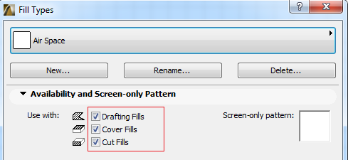

Fills - set fill usage
Do you have any idea where to set these parameters in API?
1 REPLY 1
ReignBough
Use ACAPI_Attribute_Modify() function while changing the flags value in API_Attr_Head. Here are the possible values
  • Drafting Fills - APIFill_ForPoly
  • Cover Fills - APIFill_ForCover
  • Cut Fills - APIFill_ForWall
Additional flag is APIFill_ScaleWithPlan, used for the 'Scale with plan (Model Size)'. If not set, it is considered as 'Scale independent (Paper Size)'.
I've never tried it though.
