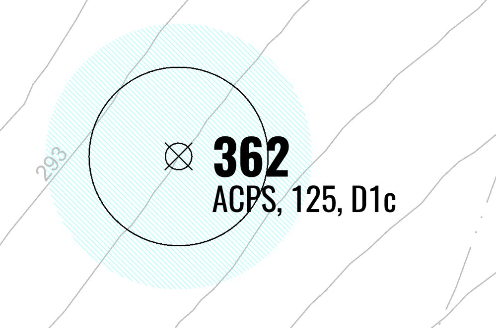

The object consists of a circular outline, a cyan hatched fill that acts as a background area, and some text (an ID number and description). Within a single instance everything looks correct: the fill sits in the background and the text is clearly visible on top of it.

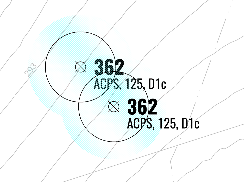

The problem occurs when I place two instances close to each other. If the cyan fill of one object overlaps the text of another instance, the fill is displayed over that neighboring text. So even though the internal drawing order of each object is fine, between separate instances the fill of one can cover the text of another.

What I would like is for the fill to always behave like a true background element and never cover text from any instance of the same object.
Is there a way in GDL to control this kind of behavior, or is this simply how Archicad handles 2D drawing order between different object instances?
Any advice would be appreciated.
4 Replies 4
Impossible... objects do not talk to each other, and even if they did or You used a workaround with writing to a text file and read the content in the other object, it probably did not help much - the drawindex position is independent by object, and You cannot put something from one object in between the positions in other.
