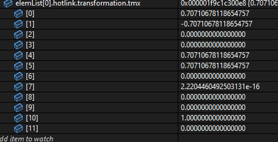

Can you please help me, I'm really struggling on how can I mirror the hotlink via API.
I think this should be done by setting the hotlink element's transmat. However, I really cannot understand how to apply reflection/mirror.
I did some research and found this reference.
Based on the documentation,
x' = tmx[0] * x + tmx[1] * y + tmx[2] * z + tmx[3]
y' = tmx[4] * x + tmx[5] * y + tmx[6] * z + tmx[7]
z' = tmx[8] * x + tmx[9] * y + tmx[10] * z + tmx[11]
I tried to play around with the angle and mirror settings, but I got lost in betwee.
For example,
I placed the hotlink in 45Deg not mirrored,

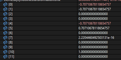

Then I placed the hotlink in 45Deg mirrored,
If you will notice, tmx[0] and tmx[4] were negated.
I really don't know how to know which tmx index to negate.
I would appreciate it if you could guide me on this. (Helpful reference would be very much appreciated as well)

A matrix is transformed by multiplying it by a transformation matrix - don't think of this as just multiplying individual values. So a 4x4 matrix for a 45° rotation (A) looks like:
0.70710678118654757, -0.70710678118654746, 0, 0,
0.70710678118654746, 0.70710678118654757, 0, 0,
0, 0, 1, 0,
0, 0, 0, 1
The transformation matrix to flip across the y axis (B) looks like:
-1, 0, 0, 0,
0, 1 0, 0,
0, 0, 1, 0,
0, 0, 0, 1
A . B looks like:
-0.70710678118654757, -0.70710678118654746, 0, 0,
-0.70710678118654746, 0.70710678118654757, 0, 0,
0, 0, 1, 0,
0, 0, 0, 1
If you imagine the operations applied to a shape, mirroring also affects rotations. If you looked at a top spinning clockwise in a mirror it would appear to be spinning anti-clockwise, i.e. the mirror reverses the rotation direction. That's why you see multiple values change.
Ralph Wessel BArch
Central Innovation
Thanks for the feedback.
I was able to get the equivalent transmat values based on your response by applying a combination of reflection and rotation (performed 2x2 matrix multiplication)
