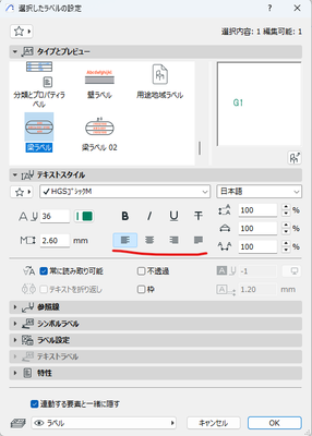

2025-10-17 02:05 PM
Hi Arad,
AC_ parameters cannot be changed from the API, as they are controlled directly from Archicad (see the GDL reference guide, section "Parameters for Text Handling").
It seems that the API currently ignores the text settings when you create a symbol label. So, my idea is to set the default parameters for a text label (including justification), then create the symbol label. (and set the defaults back if needed)
Best, Akos

2025-10-21 02:12 AM
Changing the default label settings first worked well.
Thank you very much, Akos.
