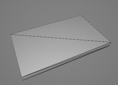

HalitYagar
Yes I am also putting window/door guids into that function and it gives me complete geometry of the object. However I cannot get the openings on the walls that have windows on it. I have a simple project with a wall and a windows on it. I can get the wall and windows using guids and Model_Access_API. But I cannot see the opening on the wall where the window should be. Is there a way to get that?

HalitYagar
 I expect the wall should have a hole in its geometry representation where the window placed. But maybe I am thinking wrong.
