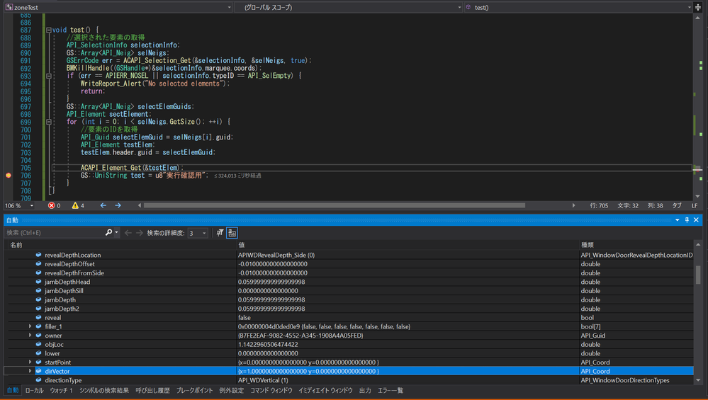

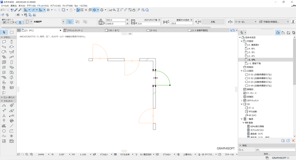

I want to get the "vector" of the selected door.
I tried to get it from dirVector of API_DoorType, but it didn't work.
How can I get a vector successfully?
Also, please let me know if there is another way to get the vector of the door.
void test() {
	//選択された要素の取得
	API_SelectionInfo selectionInfo;
	GS::Array<API_Neig> selNeigs;
	GSErrCode err = ACAPI_Selection_Get(&selectionInfo, &selNeigs, true);

		API_Element testElem;
		testElem.header.guid = selectElemGuid;
		ACAPI_Element_Get(&testElem);
		GS::UniString test = u8"実行確認用";

According to the documentation (https://archicadapi.Graphisoft.com/documentation/api_windowtype-api_doortype?s=doortype) the "dirVector" field is only relevant for doors in polygonal walls. So in case of your straight wall it's not useful.
I ran into this problem a while ago, but can't remember all the details. Roughly what I did is to calculate the vector from the parent wall beginning and end point. wall.endC - wall.begC and rotate 90deg. The parent wall GUID should be in the "owner" field of the door.
For curved walls you could rotate the radius vector to the center of the door (door.objLoc).
All of this is even trickier if you also want to have the vector point in the correct opening side for all possible door flip settings. You need to check door.openingBase.refSide/oSide.
I hope this helps a bit.

void test() {
	//選択された要素の取得
	BMKillHandle((GSHandle*)&selectionInfo.marquee.coords);
	if (err == APIERR_NOSEL || selectionInfo.typeID == API_SelEmpty) {
		WriteReport_Alert("No selected elements");
		return;
	GS::Array<API_Neig> selectElemGuids;
	API_Element sectElement;
	for (int i = 0; i < selNeigs.GetSize(); ++i) {
		//要素のIDを取得
		API_Guid selectElemGuid = selNeigs[i].guid;
		API_Element doorElem;
		doorElem.header.guid = selectElemGuid;
		ACAPI_Element_Get(&doorElem);
		API_Element wallElem;
		wallElem.header.guid = doorElem.door.owner;
		ACAPI_Element_Get(&wallElem);
		API_Coord end = wallElem.wall.endC;
		API_Coord beg = wallElem.wall.begC;
		API_Vector wallVec = {end.x - beg.x, end.y - beg.y };
		double sizeVec = sqrt(pow(wallVec.x, 2) + pow(wallVec.y, 2));
		API_Coord wallUnitVec = { wallVec.x / sizeVec, wallVec.y / sizeVec };
		API_Coord moveVec = {wallVec.x * doorElem.door.objLoc /sizeVec, wallVec.y * doorElem.door.objLoc / sizeVec };
		API_Coord doorPos = {wallElem.wall.begC.x + moveVec.x, wallElem.wall.begC.y + moveVec.y };
		API_Coord normVec = {sqrt(pow(wallUnitVec.y, 2) / (pow(wallUnitVec.x, 2) + pow(wallUnitVec.y, 2))), sqrt(pow(wallUnitVec.x, 2) / (pow(wallUnitVec.x, 2) + pow(wallUnitVec.y, 2)))};
