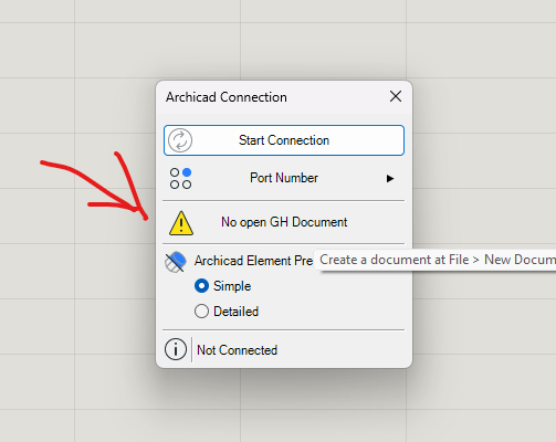

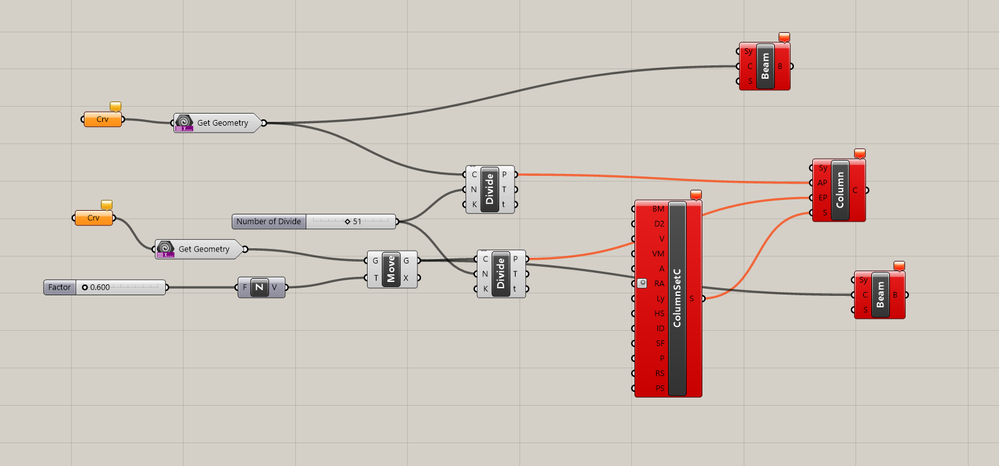

I have created a GH file (create some columns and beams in ArchiCAD, as shown below) that can be used with Grasshopper Player. Now I just want to use Grasshopper Player to run that GH file without opening Grashopper.
Can I run the GH file above without opening it in Grasshopper?
I see in the ArchiCAD connection section that you need a GH Document to connect. So how can you connect Grasshopper and ArchiCAD without opening the GH file?
Thanks in advance

Hi @Gino Hansen ,
Thank you for your answer,
Hmm, So we don't have any way to use the Grasshopper Player for Grasshopper ArchiCAD Connection, Right?
I wouldn't say no...but I can't see the advantages at the moment. But feel free and try everything that comes in your mind. Any progress is an outcome of trying something 😃.
