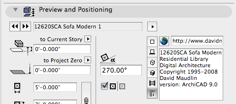

Ok, I select some object, open it in the library object editor, click on the Comment button and fill the right text area with some URL.
But I cannot see anywhere the Earth icon to follow this URL! Please, help!
David Maudlin
Rockstar
Vladimir:
In the Object dialog box, the Comment option of the Preview must be selected for the Comment and www link to appear (most users never select this option).
