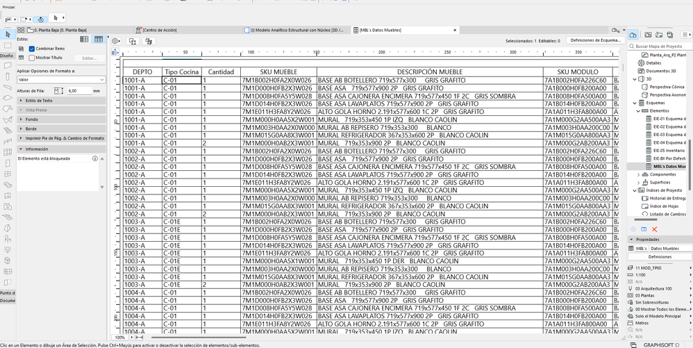

I need to export schematics of my project in Archicad 27
I am just starting with development in C++ and I use Python, which is my strength. I wanted to ask you how I can obtain one or more schematics that are in my ArchiCAD project. The idea is that I can obtain this information from my Python application. directly from the python application, I do not need the designer to use the save as option, and the publisher is not the idea of ​​​​using it but rather this communication is abstract, can someone guide me please, as I mentioned, I am just starting

Hi Stryker,
You can find a few examples here: https://graphisoft.com/downloads/python -- look at the one that exports the properties.
Note that the JSON/Python interface is not actively developed, but all previously announced functionality works.
