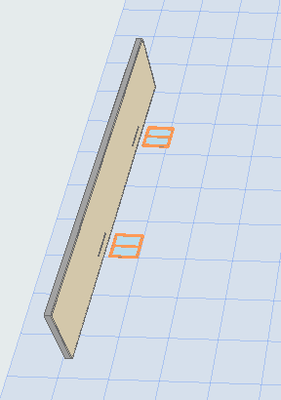

However, the created window was placed parallel to the ground and not parallel to the wall. (Had tried both the options of choosing the plane Current Plane and horizontal plane). Is there any way to correct this scenario?

This shows that the saved objects don't have the proper subtype: they are simple objects instead of windows. Save As Object – as its name implies– creates objects, not windows.
