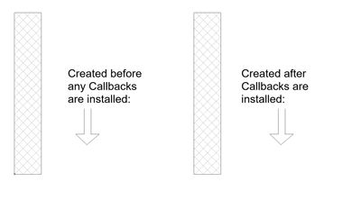

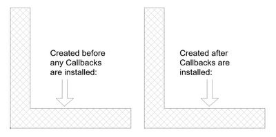

are you sure the example is able to get a notification of a deleted element that has been created before the ACAPI_Element_CatchNewElement Callback has been hooked?
both walls get deleted
Only one deletion can be seen in the Element Manager:
From my understanding it is not possible to get any changes of elements that have been created bevore element callback methods have been setup. from my point of view defeats this functionallty the purpose of a element callback system. furthermore would this mean that the element callback system is not consistent to other callback systems like the  Project Operation- or the Selection Callbacks, they can catch any changes made to the database.
