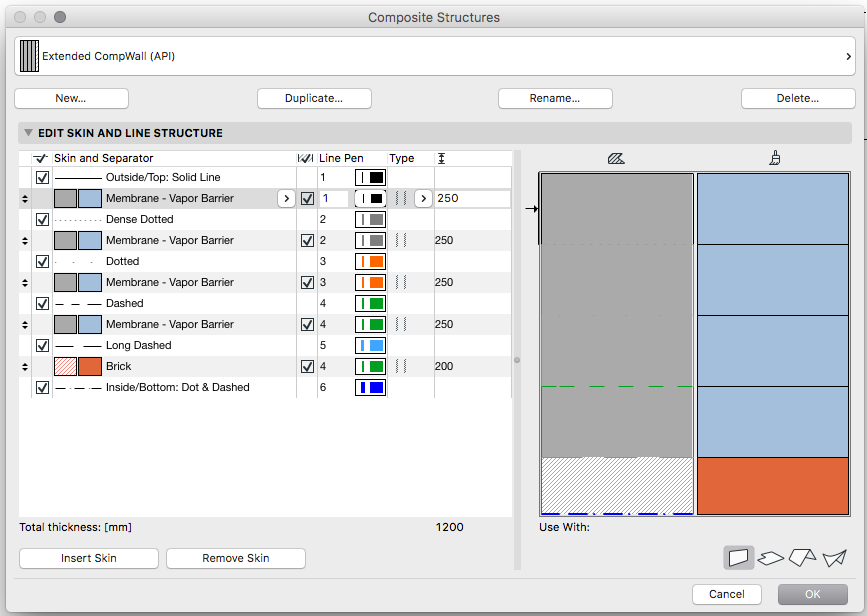

Hello,
Is it possible when creating a new attribute (for example a composite) to be available when creating a roof element? I see that it can be set manually from attribute manager, or when editing the composite window from the four buttons at the bottom right (see the atached image) but I can't understand how it can be done programtaically.
I would be very helpful for some guidance in the documentation maybe, because i can't seem to find anything there.

Hi Julian,
Set the following flag before creating the attribute (for composites):
attribute.header.flags |= APICWall_ForRoof;
Best, Akos
