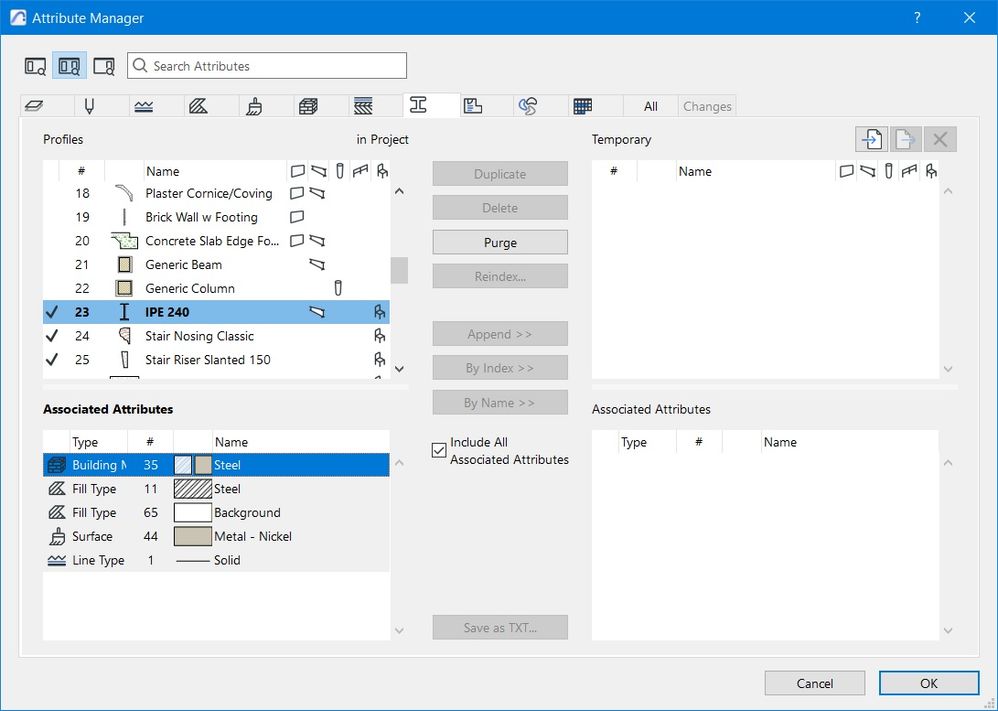

How can I get the materials of a profile?
I use complex profiles with columns and beams and want to get their materials but have no idea how to do that. Any suggestions or hints? Thanks in advance.
