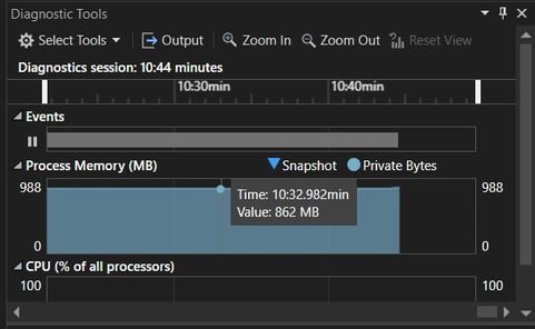

My plugin crashes at random places on AC28 but the same code works fine on AC27 and AC26.
Here is briefly what I am doing: I have a function that creates composite structures in a loop (Walls/Slabs/Roofs). Some of the materials already exist (created by the previous composite) and their properties are overwritten. The same apply and for all composites - their properties are overwritten if a composite has already been created. The first time I call the function all composites are created successfully. If I call the function again, some composites and materials are overwritten and then AC crashes.
Again, this happens on AC28 only.
Here is a screenshot of a typical crash
and the corresponding call stack

Exception thrown at 0x00007FFDC9CD2E0C (ObjectDatabase.dll) in Archicad.exe: 0xC0000005: Access violation reading location 0xFFFFFFFFFFFFFFFF.
This looks like dereferencing a null pointer or trying to release memory that has already been released.
Also, I noticed AC28 use a whole lot of RAM compared to AC26 (and AC27)
Any ideas what might be wrong and how to fix it?

kolioi
Fixed
Based on the info in this article
New memory allocator in Archicad 28
