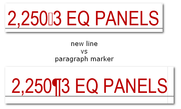

I found out that the note in dimension can now be a multi-line. But when I tried using "\n" it was shown as the replacement character "▯" but it is correctly displayed in the settings dialog. When I tried using paragraph marker, "¶", it is shown as it is.
EDIT: (2016 Feb 02)
What I did was:
for new line:
sprintf((*memo.dimElems).note.content, "<MeasuredValue>\n%d EQ PANELS", panelCnt);
for paragraph marker:
sprintf((*memo.dimElems).note.content, "<MeasuredValue>¶%d EQ PANELS", panelCnt);
~ReignBough~
How about creating a multi-line dimension manually (i.e. with ARCHICAD's tools) and then examining the resulting data through the API to see what delimiter it uses?
Thanks. Found it. It is ASCII 13, or 0x0D, or '\r'.
