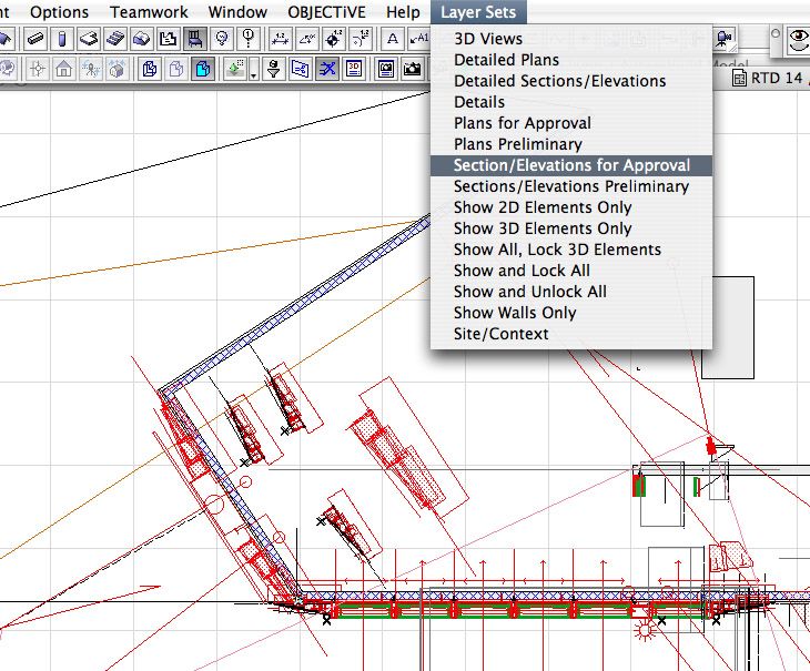

Is it possible you clever developers? I figure a box with the layer list where one could turn on/off layers in real time so that the model view updates accordingly. Purpose is to show different alternatives very easily and quickly.

Let's see. You think that want a box to directly switch layers to show design alternatives.
Except you really need to have a quick switch between later SETS, because anyone who actually produces a building DESIGN knows that multiple layers is better than one. And we sort of already have this in the layer sets list buried at the third level beneath the document menu dropdown. Some planning of the layer sets gets you a straight-forward presentation set....
What if, using the customizing tools already present in ArchiCAD, and without any gobbledigook programming, we could get a layer set list to appear in the menu list bar at the top of the screen? Would that do it? [This is a great way to promote anything that can't be shortcut any other way]
Using the Menus options under Work Environment we can create this list. See the attached. Yes, it does need to be pulled down, but it is very direct.
Likewise, if you can at all organize your design alternatives, and save the views, there are many view options in the organizer/ navigator listings. So there they are, right next to the drawing layout.....

And here I am yammering on about layer sets when you want to switch individual layers on and off, but I found a "Quick Options" thingy that also lets you switch layer sets quickly.

It's already there, in AC9 anyway, just one more step than yours, Dwight.
Options>Layer Combinations>
Yep - Quick Options (in AC10) is the closest thing so far. At least you can switch between layer combos. It's a good idea IMHO to always have at least one Modeling & Drafting layer combo, not to assign to a view, but just to use when modeling and drafting.
i have the 'show/hide quick options palette' assigned to a single key shortcut (Q), which pops it up right in the middle of the screen and closes it again when i'm done . . . works well.
