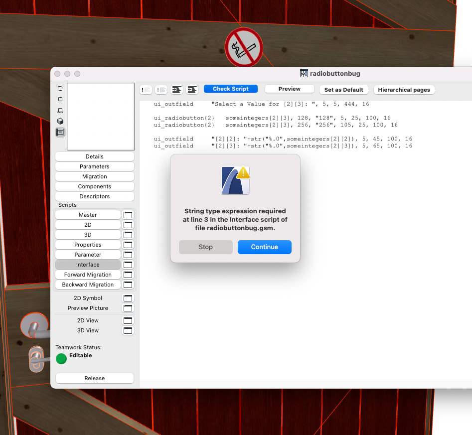

Hi All,
I am trying to use UI_RADIOBUTTON with a 2 dimensional array parameter. However if I ask for _param[i][j], it will always store the value in [i][i] instead, making this command useful in the diagonal matrix only.
I hope I am not missing something obvious - but this appears to be a bug to me...?
Many thanks in advance, I'll love to hear your thoughts.
UI_RADIOBUTTON stores values into [2][2], not [2][3] as specifiedUI_RADIOBUTTON stores values into [2][2], not [2][3] as specified
Tested in AC23 and AC25, latest patches.

Hi Piotr, many thanks for your reply. I thought UI_RADIOBUTTON{2} only take string expression for the parameter and its not taking "someintegers[2][3]" nor someintegers[2][3]. Am I missing something?
Thanks in advance.

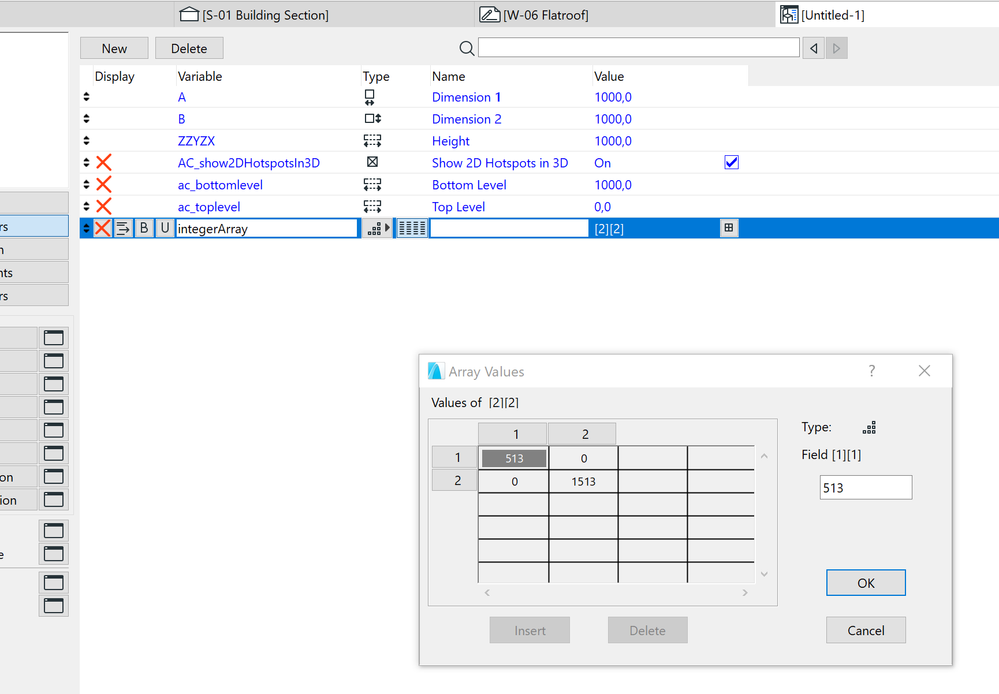

Just to be very clear what would happen:
Sorry I did not do a test...it works with original one...
 Parameter is integer
UI_RADIOBUTTON{2} integerArray[1][1], 513, `test Value1`, 10, 140, 100, 20
UI_RADIOBUTTON{2} integerArray[2][2], 1513, `test Value2`, 10, 160, 100, 20
