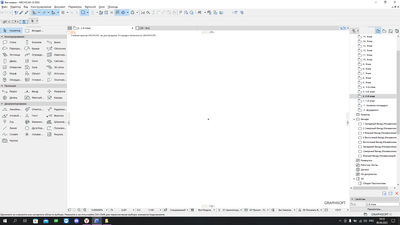

I lost the visibility of all floors on the plans. There is an orange artifact on the top left. In 3d form, everything works correctly.

Somehow your zoom is at 0.0000000%.
Try changing that to one of the pre-set zooms by clicking on the little black triangle.
