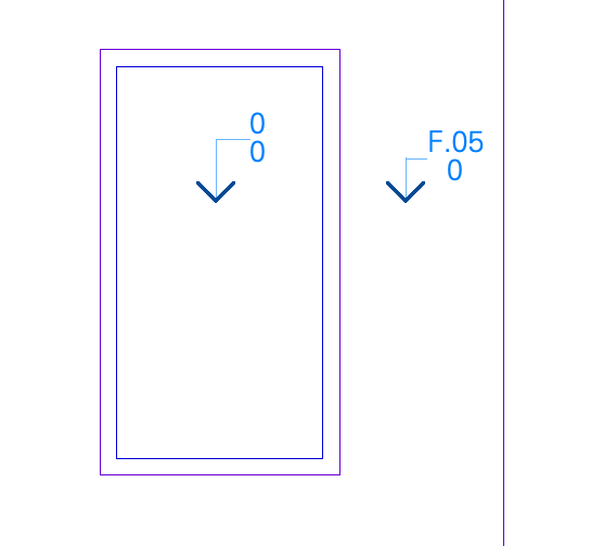

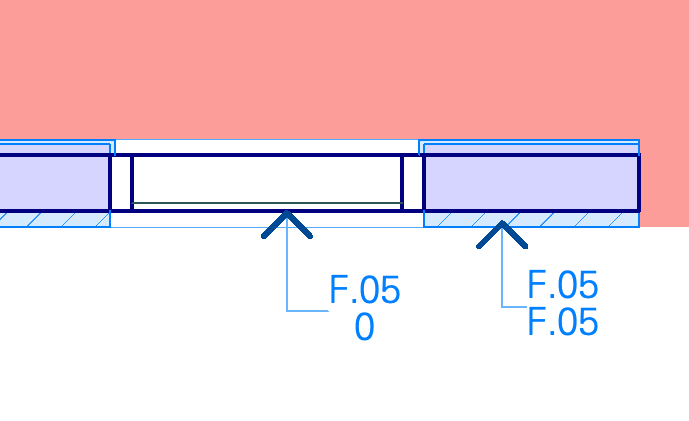

Hello All, I am having trouble getting my window label to read the zone information in elevation.
A Label GDL on a window with "Zone_relations_of_owner" reads zone number correctly when tagged in plan. But it returns "0" when tagged in elevation.
n = REQUEST ("Zone_relations_of_owner", "",ZONECATNAME, ZONECODE, ZONENAME, ZONENUMBER)
TEXT2 0,0,ZONENUMBER
However under the same settings a Label GDL on a wall with "Zone_relations" reads zone number correctly in both plan and elevation.
n = REQUEST ("Zone_relations", "",ZONECATNAME, ZONECODE, ZONENAME, ZONENUMBER)
It would be great if someone can help me figure out how I can get the label to read zone number when tagged on a window in elevation view. Thanks for reading.

Peter Baksa
this might be a bug, as REQUEST "WINDOW_DOOR_ZONE_RELEV_OF_OWNER" works correctly and reacts to flipping. I will report it.
You can use autotexts as a workaround.

Peter Baksa

JP1
Thank you Peter. I am very much open to your suggested workaround. However I am not familiar with autotext in GDL - perhaps you could explain a bit further for me.
I figured the autotext #From Zone Number returns the information I need but not sure how to apply it into text2.

Peter Baksa
I meant autotext without GDL.
The best way to get the ID of an autotext is creating an autotext, and dragging it into a 2D script.
The element-based autotexts are techically properties identified by a GUID:
<PROPERTY-EDC44824-1A6D-407A-9E39-693066622E7D>
These can change between plan files and versions. Archicad takes care of changing them if they are parameters (try saving an autotext as an object), but it means you can't use a hard-coded value.
Another workaround is that autotexts under General Parameters are also available as a property. Properties can be displayed this way: https://gdl.graphisoft.com/tips-and-tricks/display-properties-with-labels
