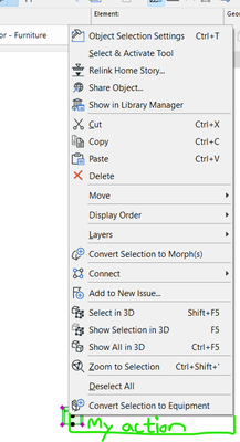

6: Somehow make the action appear in the context menu of the element, haven't found a way to do this. Probably not possible, but I hope I'm wrong:

  3. Concerning your 6th point about appearing in the context menu. You could "hijack" user interaction before it reaches Archicad (lots of different ways to do that, but nothing "native" to the Archicad C++ API) and then let that interaction trigger something in your Add-On (either directly send something to the Add-On or let the "hijacker" display your own context menu first on e.g. CTRL+Right Click). It's probably quite cumbersome to make that platform independent and I haven't tried it before so also not 100% sure if it even works properly.
