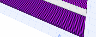

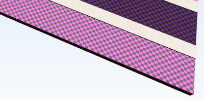

Why is the UV obtained through ACAPI_ModelAccess_GetTextureCoord API different from ArchiCAD?
Hi,everyone:
 In ArchiCad:
In my Render System:
It is obvious that the size of the texture is inconsistent(Ignore color).
I'm pretty sure the exported texture file is fine, so I think it's a UV issue.

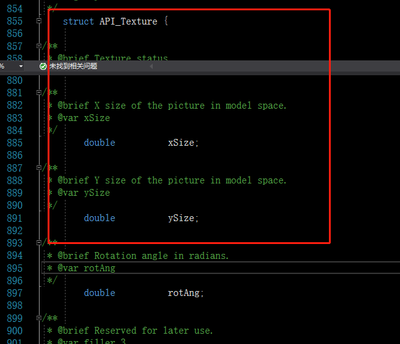

1 Solution
sxs
if (err == NoError)
						uv.push_back({ resultUV.u / xSize, resultUV.v / ySize });
It seems that the following actions need to be taken.But the xSize/ySize I get can not produce the correct effect.

sxs
@sxs wrote:
if (err == NoError)
It can work.
The reason is that the texture is missing.
