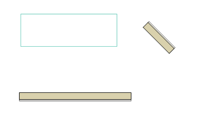

attrib.header.index = i; is error.
I'm studying the previous code, but I can't put a constant in the index. What should I do?
for (UInt32 i = 2; i <= count; i++) //I starts from 2 because 1 is Archicad layer
BNZeroMemory(&attrib, sizeof(API_Attribute));
attrib.header.typeID = API_LayerID;
err = ACAPI_Attribute_Get(&attrib);
API hide all layers - Graphisoft Community
Q2. Looking at this code, it seems strange.
Count and index are not the same thing, but it looks as if the index is set in count order.
I don't think you can do full Hidden with this code.
Is full Hidden possible?
Where can I study?
err = ACAPI_Attribute_GetNum(API_LayerID, count);

1 Solution
kuvbur
What version of Archcade are you using? In version 27, the implementation of API_AttributeIndex has changed.
Try attrib.header.index = ACAPI_CreateAttributeIndex (i);
https://graphisoft.github.io/archicad-api-devkit/class_a_p_i___attribute_index.html

LeeJaeYoung
All layers are not turned off like in q2.
What do I need to study to learn the code to turn off an entire layer?
thank you ^^
