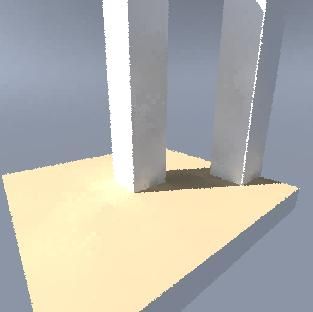

And now the Radiance image (note that textures are ignored, but Sun Position, Camera Viewpoint and View Angle is fine).
The floor was using "Wood-Pine Shiny" and the rest is "Surface-Whitewash". In the export they are both wrong and turn to
"Brick Face" and "Surface Plaster Rough".
I don't think it's a coincidence that the last two materials have been the first two in the complete list of materials, which I generated as follows (based on the API-examples):

I did not try, but I think iumat isnot material attribute index, it is API_UmatType components index of API_Component3D.

Now I get the correct material from a 3D Polygon...
It seems the the "Attribute" Material and the "3DComponent" Material are reached in a complete different way!
