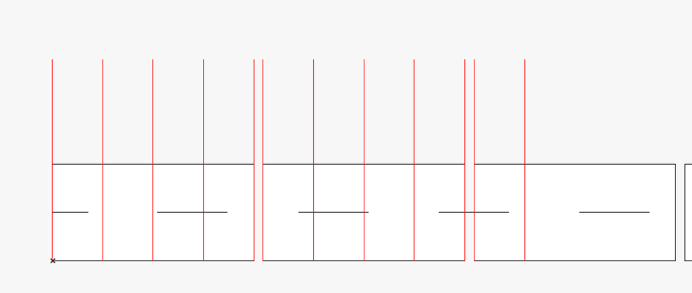

Hello,
I am trying to lock a point to only be set to specific points. Usually I would just use Step in a Values line to define it but the points aren't evenly spaced throughout it all.
Here is the script I currently have but I'm having some issues with it and I don't know where I'm going wrong:
(brick_position holds each possible dimension that the opening_point_2 variable should be able to be set to.
I would adjust the opening_point_2 variable using a hotspot in 2D plan. )

Thank you very much for taking the time to write this. Unfortunately it doesn't "jump" up in increments like I would like. I've attached an image, the red lines are the points that I would like the point to be locked to and then obviously to continue along the length of the object.

Solution
DGSketcher
Legend
@JGoode Sorted & tested. I had missed a pair of brackets in the dQtrBricks calculation. Revised code attached taken from my Master Script.

This is brilliant. Thank you very much! I never would have been able to figure this out.
