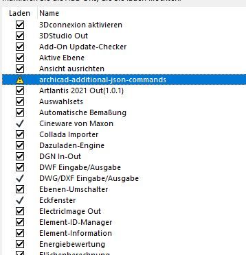

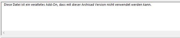

Hallo everyone,
I tried to load the Additional JSON Commands Add-On but it doesn't work. Says that the Add-On is outdated.
did anyone try working with the Add-On with the latest AC26 version?
best regards

If anyone is interested:
Tibor has also posted the source code for his AddOn on his GitHub site. To use it in 26, you will have to re compile with the 26.3000 C++ API. I have included Tibor's code in my Python extension "data_access" -- available on my web site.
data_access Python Extension
The commands in Tibor's Python scripts have not changed, so they should work equally well with the 26 compile.

Add-ons will only run in the version they were compiled for.
Was this JSON add-on compiled for version 25?
Or are you trying to use the 25 add-on?

Ady84a
@poco2013
it worked! Thank you 🙂
julienK
I have the same problem with one of my addons.
in vs2022  i  recreated the solution. the cmakeList clearly specifies AC26. made sure I'm using v142 toolset
Cleaned the solution ,  rebuild it,  no errors, but ac26 still won't accept it as a valid  addon, with the same error message as OP.
