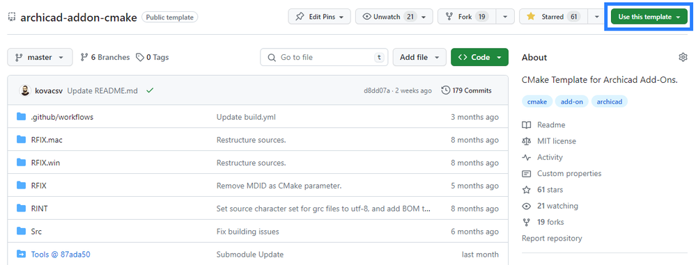

Start building your own Add-On
If you are ready to start building your own Add-On, create your very own copy of the template repository using GitHub:
Now you have your own copy and everything is configured. Follow the above steps using this repository and start building your own Archicad Add-On.
