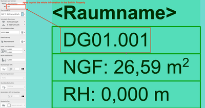

Anarchiteckt
Hey Yves,
I just spoked with the User from the Model...
He needs to "Print" the the complete Information in Room number.
With GDL, you can show the Information on the floor plan as a "prefix".
Maybe there are some possibility to made it with Python....
We could create a User Property for the the Story name and print this User Property with a Built-in Property (Roomnummer) Together.
But I have no idea what the Python code should look like....
Does anyone have any ideas?
