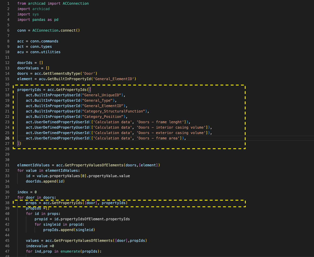

Hi Gerry!
Thank you very much for your script. I tried to modify it to include only selected properties, but I might be doing some mistakes. Can you please help? Thank you very much. (attached screenshot)

I think there is at least a comma at the end of your "propertyIds" thaht should'nt be here. I'm not sure that this is the only problem.
(You should share the code and not a screenshot to help to debug it)

‎2023-03-17 03:32 PM
Hi! Mathias, Thank you very much. Here is the code

‎2023-03-17 07:01 PM
Line 38 is incorrect since you already defined the property Ids. Delete this section and just set
propIds = propertyIds --- see attached The function getpropertyIds does not take a element(s) (improper usage)
Delete everything after line 69 --- not needed.

‎2023-03-17 07:04 PM
Hi Gerry! Thank a lot! 🙂
