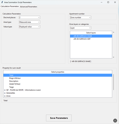

I updated my sum area script (it puts the sum of all area with the same identifier in a custom property in each of the affected zones).
I also made a "translation" system : the script will check the language code (FRA for the french version for example) and will verify if there is a corresponding file in the parameters folder. For example, translations_FRA for the french version, and will use this file to change the script language.
I strongly advise you to install the opensource/free Tapir plugin for archicad, which provides a palette to launch the script, here: https://github.com/ENZYME-APD/tapir-archicad-automation?tab=readme-ov-file#archicad-add-on
New in V3:
-New option: only takes into account zones with a certain custom property value.
-New interface that automatically loads previously used parameters.

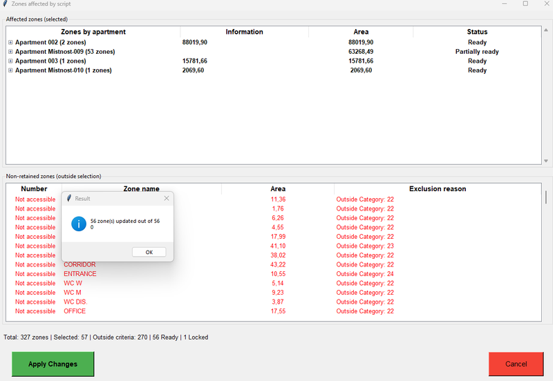

New option: three script launch modes: silent, light pop-up (number of zones updated), full report (for debugging/verification) but slow.

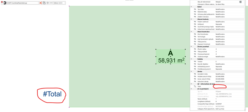

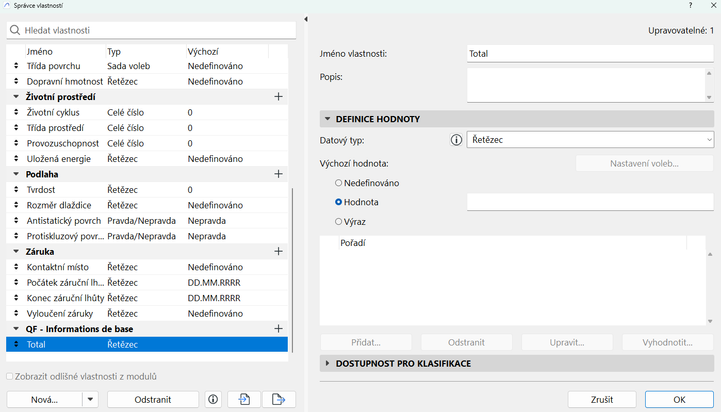

I run into a problem, probably you could explain to me what I am missing... I created a custom property for Zones with the name Total and string data type
but after running a script, I don't get the sum value automatically added to that property... what could be the problem? The classification is attached to zones.
Is it because of no translation for my language?

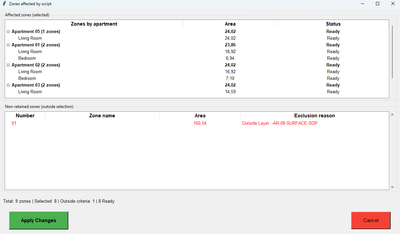

These are the results I expected to see in the Total property:

After I click on apply changes I get:
And the number appears in the total property now, but I don't know how to attach it onto the label for each zone...
How do you get for each zone type different amount of Total on the label?

I don't really understand. How do I display the total in plan? I'm using a classic text/autotext label that retrieve the custom property.
You can use the script with different settings and tell the script to put the result in 2 or more different custom properties. Then, you juste have to update your label to retrieve those 2+ custom properties.
Archicad 27 - GDL - PYTHON
magdak
Ohh, I forgot I have basic zone stamp that didn't offer this label property. When I change it to the complex zone stamp then it works well...
