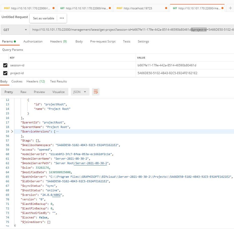

I am currently looking for possibilities to extract data on all created projects from the vbim server using the BIMcloud API.
Regular queries and storage of the information should take place.
However, I am a bit stuck, I am using the repository with the BIMcloud API specification.
https://github.com/GRAPHISOFT/bimcloud-api
My approach is as follows, I have the URL for the server, as well as username and password.
With the ManagerAPI class I create a session with create_session() and get the session_id as return value. Which I then use in the get_resource() function. But from the get_resource() function, I don't get all the data from the server.
Or if I knew how to get the data for a project, I could iterate over all projects.
I would be very happy about some food for thought?

Solution
leilei
HI.
If you want to get all project information, you can try calling like this GET:http://ip:22000/management/latest/get-projects?session-id=xxxxx
If you want to get all project information, you can try calling like this GET:http://ip:22000/management/latest/get-project?session-id=xxxxx &project-id=xxxxx

Hello Noemi Balogh,
thank you very much for responding so quickly. After reading your message, we dropped our approach with the BIMcloud API.
And we took an approach via GET request using Curl and have now successfully extracted all the information about the projects.
Kind regards,
Ata
Hi leilei,
Thank you for your comment regarding GET requests using Curl.
We have used a similar query:
http://vbimmanager:20000/management/client/get-resources-by-criterion?session-id=xxxx
to extract all possible information from the vbimmanger.
We will try your get methods as well
Kind regards,
Ata
